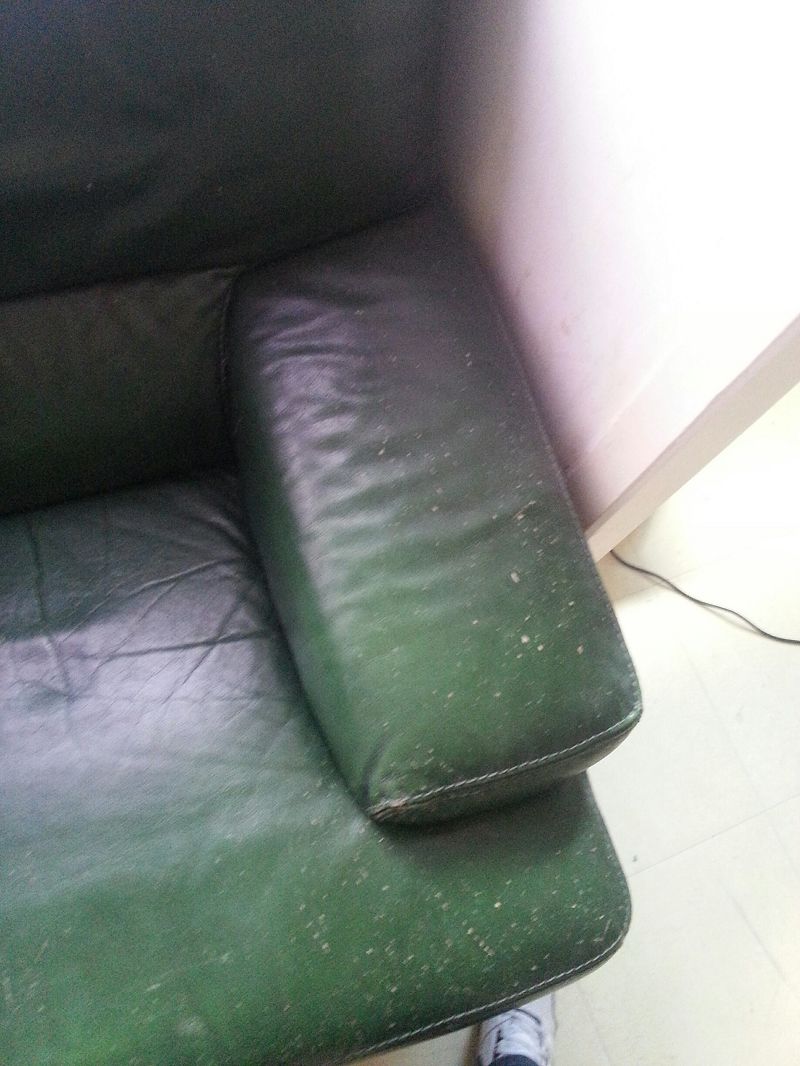

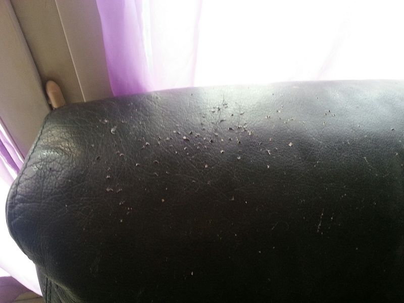

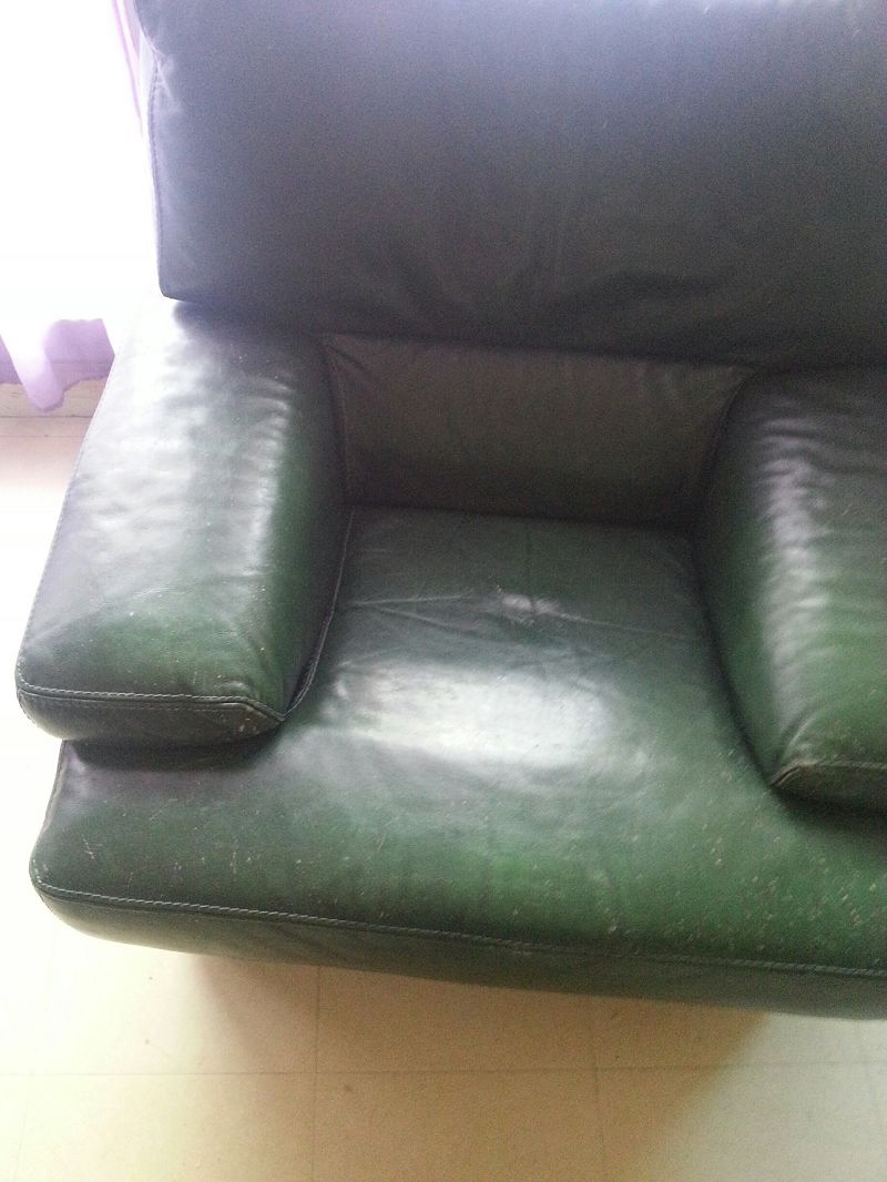

Hello I would like to renovate and dye in black my chair my cat has made its claws on several places where the rebic leather can you advise me for the products to use

    You have no other solution than to recolour after applying the repair paste. You will have to sand the leather to make the parts that bounce back then fill the cracks with the paste, stop spreading paste when the surface is smooth, recolour and varnish. You need the leather renovation kit 1 armchair. To provide you the right colour, cut a piece of leather under the armchair or inside the cushion and send it to us.
    Thank you for your quick answer?
    It's a khaki-colored armchair I have to provide you with a sample I want to recolor it in black
  3. Reply
    No, you just have to order the leather renovation kit 1 black armchair.
