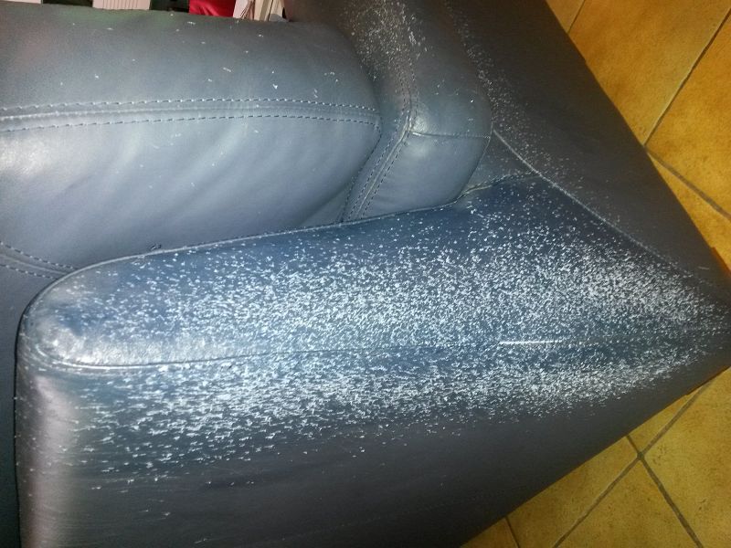

My leather sofa has been scratched by my cat in several places ( 4 zones 70X20/70X15/20X30/40X30 cm)
Which product do you recommend and how much? How to find the colour that best matches the sofa (night blue)

    For the repair of your cat scratches, you will need to apply our RepaCuir (liquid repairing leather).
    First of all, the leather should be lightly sanded with 240 grain abrasive paper to remove small parts of raised leather.
    Then degrease with acetone (without stripping), and apply the RepaCuir with a spatula in very thin layers until you obtain a perfectly smooth surface to the touch.
    Once your leather has been repaired from cat scratches, you will then have to recolour your sofa because the RepaCuir is white in colour.
    The colour of your sofa can be made either from a paper colour chart that we will send you, or (ideally) from a small leather sample (1cm mini), to be taken from a hidden part.
    To simplify the selection of the products required and their respective quantities, we offer complete leather sofa renovation kits adapted to the dimensions usually found.
