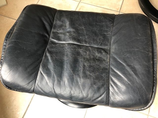

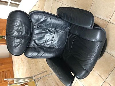

We need to renovate 4 armchairs and 2 poufs of the Stressless brand in dark navy blue.
What would you advise us to do? See the attached pictures: they are slightly cracked and discoloured.

    Navy blue is a colour that covers relatively well (compared to very light colours). Consequently, to renovate your 4 leather armchairs and 2 Stressless beams, we recommend that you purchase the following products:
    - 200ml of Sebum Cleanser (if you have traces of sebum
    )- 2 tubes of RepaCuir (white or black whatever)
    - 1 litre of Pigment Recolourer
    - 500ml or 2 spray of Silky Varnish-
    200ml of Nourishing Oil-
    Optional renovation accessories
    Concerning the choice of color you have 2 possibilities:
    1. sendus a small sample of the leather to be taken from a hidden area.
    2.choose a color from the SOFOLK or RAL color chart
    If you choose to send a sample, in the color menu of the pigment recolorant or kit select the option I provide a sample. Finalize your order, and send your sample to our factory daArtigues with your order number.
    If you choose the other solution, we will send you, upon receipt of your order, a numbered paper colour chart containing about twenty variations of your colour.
    Of course, we will also send you a complete instruction manual along with your products.
