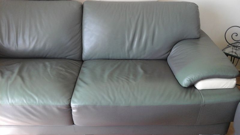

My sofas have faded with the sun and have gone from anthracite grey to bottle green except on the base. Which kit should I use to turn them back on? How to find the same original shade as the base? How much should I order? Is there a possibility to receive a shade and a sample before ordering?

    In relation to the colour and size of the sofas, provide 2 litres of pigment recolouring agent and 500 ml of varnish. You can use acetone for cleaning and we offer you edible oil (mention it in the order comments).

    No, you must not dilute the acetone. We can send you a colour chart but you can also print a piece of paper of the right colour by clicking on 432 colours chart.

    How does it work if I send you a small sample to get the original color: or should I send it?
    Should I wait for your news about the sample before launching the order?
  5. Reply
    You must send the sample to: SOFOLK Darnat 24490-LA ROCHE CHALAIS
    You can place your order at any time by selecting from the drop-down menu colours' leather sample supplied or already supplied'.

    Following our exchanges of emails that guided me well, I will finalize my order knowing that you have received my sample for the shade.
    I would like to know the quality of the varnish I need to order: matt, satin or gloss depending on the photo transmitted because I don't know which quality to choose so that it comes closest to the original quality. Do I have to send back one more picture ready to be informed?

    Choose satin.

    I received my order well except the paper to sand but it's okay here I am. I passed acetone and slightly sanded the seat of the first sofa. Do I have to apply two coats of dye and how long does it take to dry between the two passes?
    What should the tools be cleaned with: water or white spirit?

    In general it is 2 coats except for color changes. The tools can be cleaned with water. Sorry about the sandpaper.

    I just finished colouring the 2-seater sofa (2 coats): the result is amazing...now it's time to varnish: how many coats?? and should I use a small foam roller or a sponge???

    Sponge the varnish after having slightly moistened it, apply another coat in 3 weeks for a good protection.
