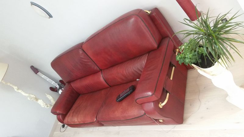

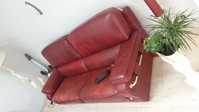

I have 2 thick leather canapes of very good quality currently in burgundy, I ordered 2 kits to recolour them in grey, currently there are black selvedges around the armrests and seats, the ideal would be to keep them in black! otherwise, they can be painted in grey! when do you think? what is the technique if I want to keep them black?
Looking forward to your advice, kind regards Mr Segura
  • edges existing around the armrests and seats
    The best and simplest solution is to recolour without taking into account the hair piping, then once the leather is dry and before varnishing, recolour the piping with the Black Pigment Recolourant with a fine brush. Protect one side of the piping with a paint scoth and use a cover to protect the other side as you paint the hairline, this is the fastest solution
