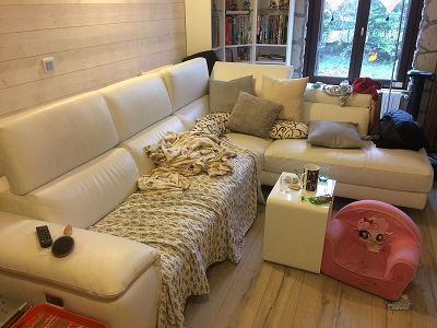

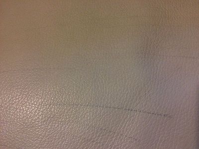

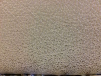

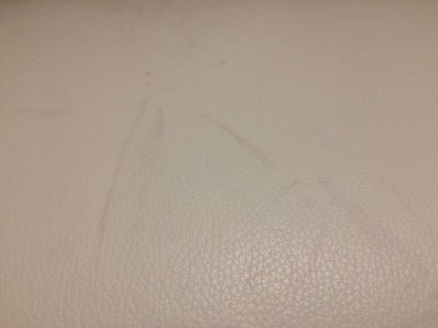

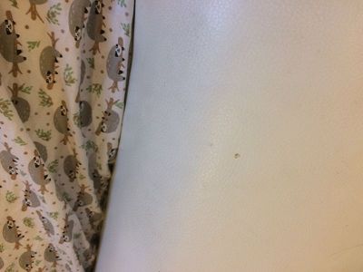

I would like to clean and maintain my white leather sofa, which I bought new a year ago. Could you please advise me on the process and the Solfolk products to use to remove the small spots in the picture (there is one that is because of a wet suit that has faded onto the leather) and to maintain and protect afterwards?

    Hello, here are the tips we give you:
    SALT LEATHER or for people who do not regularly maintain their leather:
    1-Leather cleaner / stain remover2-
    Nourishing oil3-
    Leathervarnish (in a can or aerosol), or Protective Wax
    CLEAN LEATHER or for people who maintain their leather once a quarter
    1- Cleaning oil2-
    If your stains do not leave despite several consecutive attempts with our leather cleaner, the only way to remove them is to recolour them.
    The leather consumes a small amount of oil originally incorporated by the tanner or the tawny owl at each traction applied. Only specific oils, such as SOFOLK FOOD OIL, penetrate deeply into the fibres of the leather, restoring suppleness and tear resistance.
    Originally, all leathers were protected by a varnish (matt, satin or gloss).
    These only resist several hundred frictions, which is why it is necessary to renew it at least once a year. SOFOLK VARNISHES are designed to protect the colour and allow the leather to breathe.
