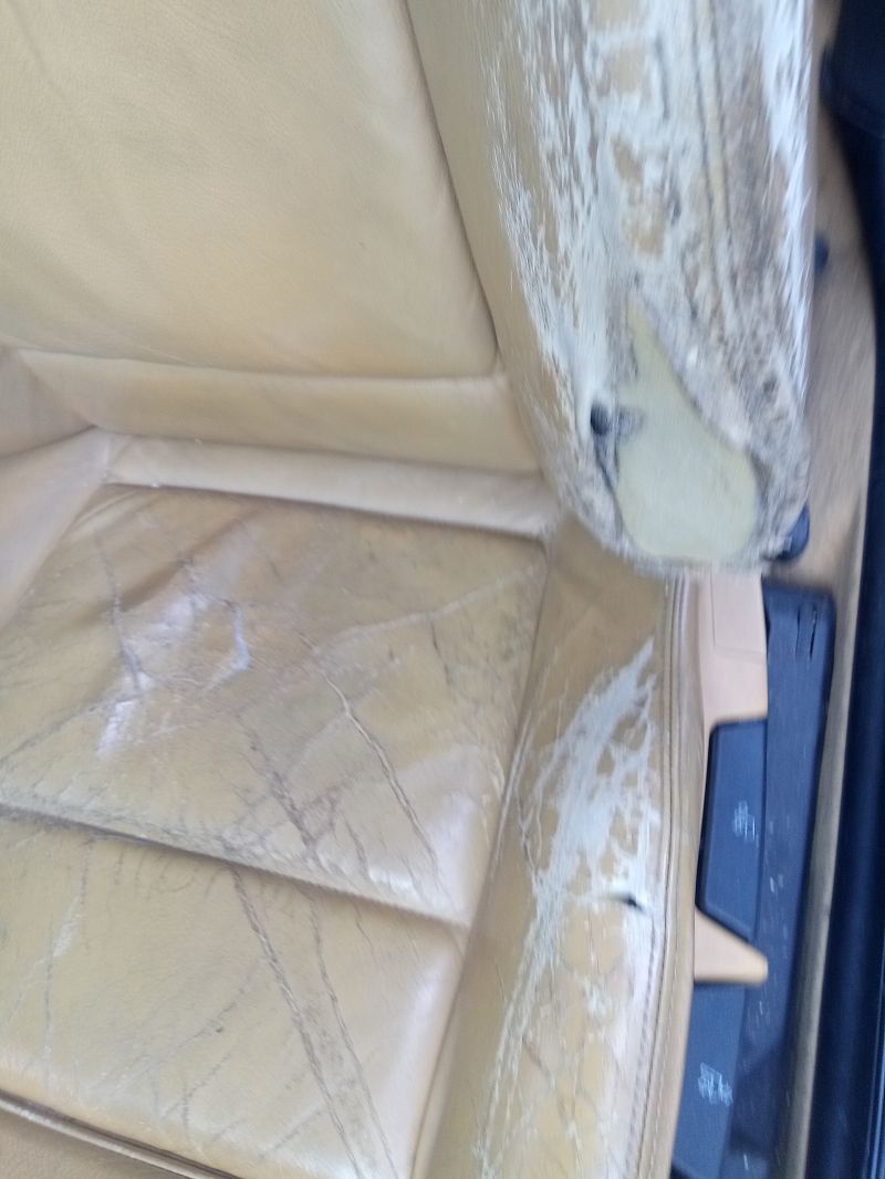

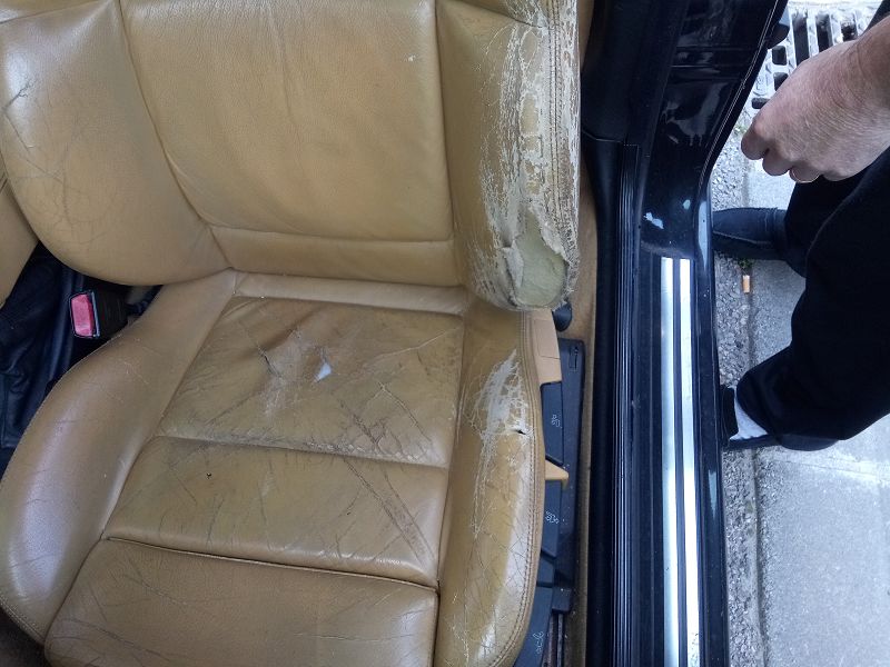

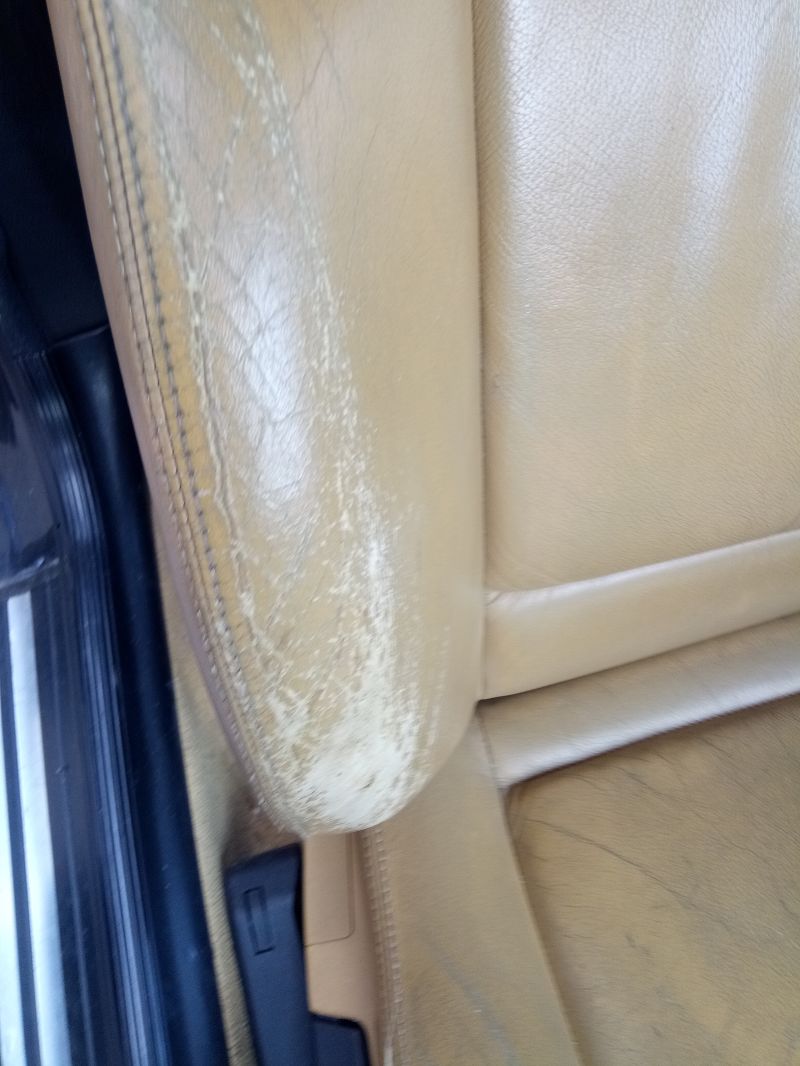

I would like to have some information as well as the leather products/stones purchased for my two front seats of my bmw e36 convertible which will be saffron yellow in my opinion
my driver's seat being quite damaged I would have liked to put pictures for you to have your opinion (which I will do after validation of the subject.)

    Hello,
    Your repair is feasible but will require significant lamination. For the backrest bead, do not hesitate to open along the length to be able to slide a piece of leather that almost entirely takes up this part to solidify this degraded leather as much as possible. The same must be done for the seat bead and also to reinforce the seat in the same way. The big job is this lamination to be done with the repair paste, we advise you to stick a second piece of leather on the first one for the backrest bead to make the operation more aesthetic and to use the impression paste for the other repaired parts. Colouring is easy but must be done on solid leather to be durable. We are at your disposal to guide you through this interesting renovation operation, you can reach us every afternoon of the week.
    Sincerely
    The SOFOLK team
