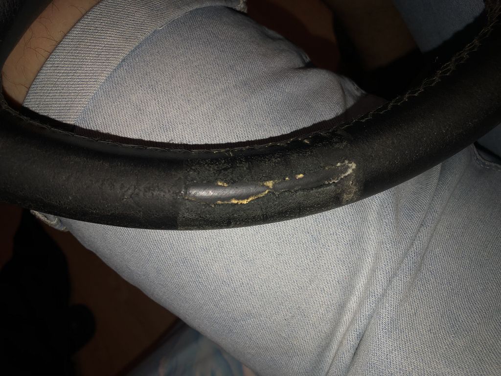

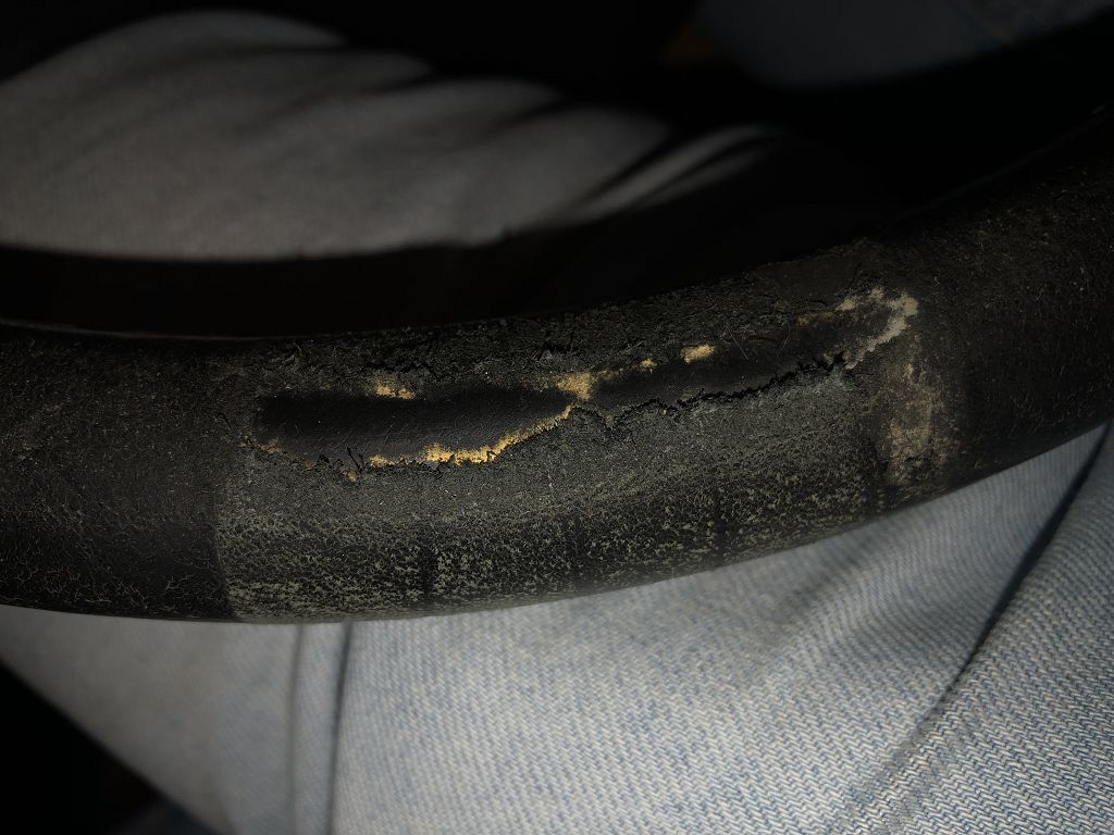

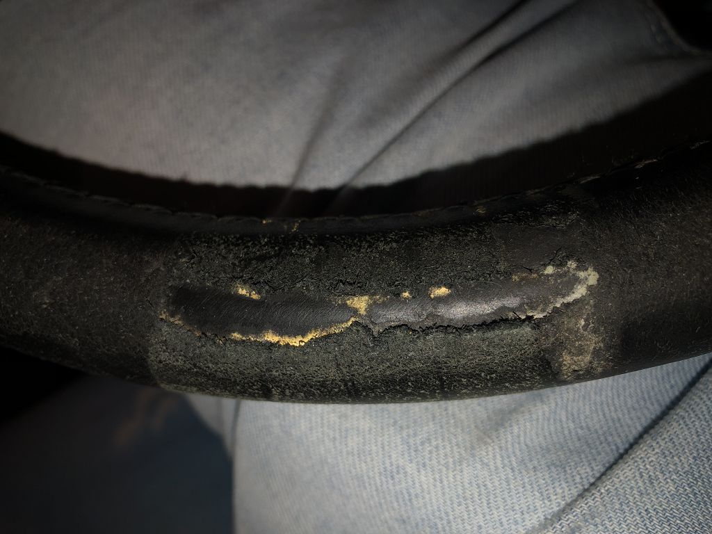

Hello I would like to know if it was really possible to repair a perforated baked steering wheel (torn 4 cm) with a renovation kit?
I attach a picture of the tear in question thank you
  • Repair of a hole in the steering wheel - 1
  • Repair of a hole in the steering wheel - 2
  • Repair of a hole in the steering wheel - 3
    To repair your hole and surface wear, recolour and protect your leather steering wheel, you will need to obtain:
    1. Leather steering wheel renovation kit here
    2. A piece of leather here
    3. neoprene glue and acetone at any DIY store
    Concerning the method, here is the link to a tuto which deals with the renovation of the leather of a steering wheel with the same symptoms.
