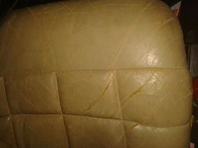

I'm considering renovating my car leather interior. The two front seats are very used (cracks and several tears, see picture)
Do you think it's still possible?
For two seats, how much repair paste is needed? 20 or 50 ml? Ditto for the pigment recolouring agent (250 or 500)
Do you offer replacement leather pieces to slide under the tears or do you have to supply them elsewhere?
I also read that you must first sand the leather before applying the treatment. Considering its current state, I hesitate a little to do it for fear of generating new tears (it is so dry). Can't I first feed him a little oil?
Thank you in advance
  • renovation of torn / cracked car seat
    You are right it is necessary to grease the leather before any repairs. We recommend sanding the leather before applying the pigment recolouring agent to ensure that the varnish is destroyed. This light sanding, with a fine sandpaper, does not damage the leather, even very dry. We provide the leather parts free of charge (please ask for it in the "comment" box when ordering). Your leather car seat is repairable, but you will have to laminate the entire leather edge with a tear. The colour of your seats as well as the porosity of the leather encourages us to recommend 500 ml of pigment re-colouring agent.

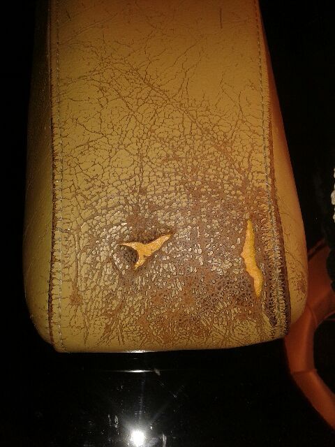

    Complementary question, of the same order: my central armrest is even more damaged. Beyond the tears, will the repair paste be enough to fill the material that has left? Or will it be necessary to replace it with a new piece of leather?
  3. Reply
    It is preferable, as for the armrest, to make a lamination on the whole weakened part so as not to have to repair within a few months a place just next to the tear.

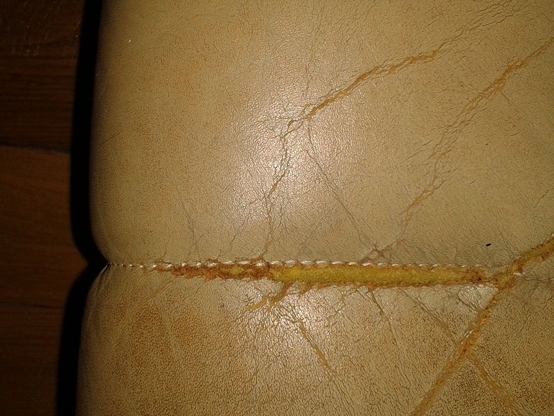

    One of the tears is at a seam (see photo). Is it necessary to remove the seam on the whole tear in order to laminate a piece of leather underneath or is there another technique in this case?
  7. Reply
    You should proceed as if it were a tear in the middle of the panel but try to remove the inner edge of the leather used for sewing to make the gluing as flat as possible.
