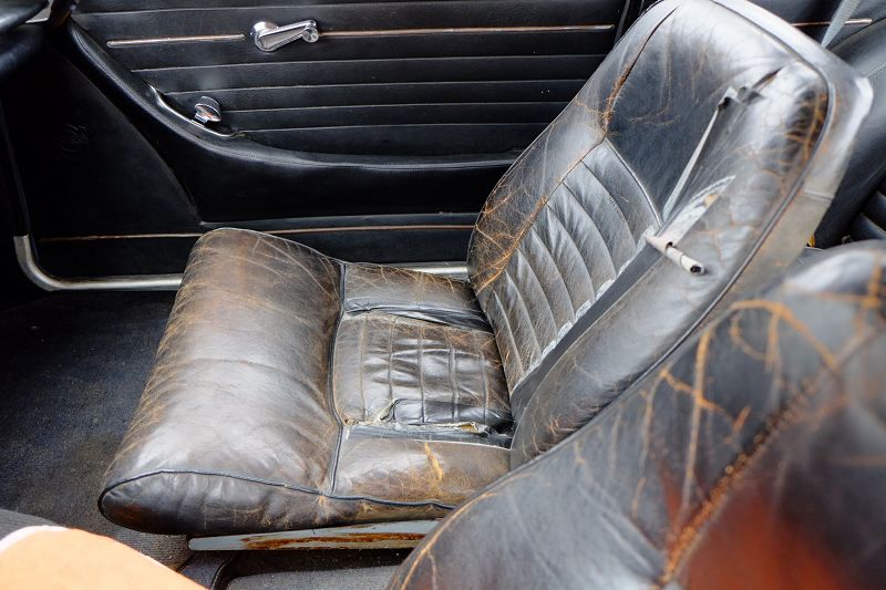

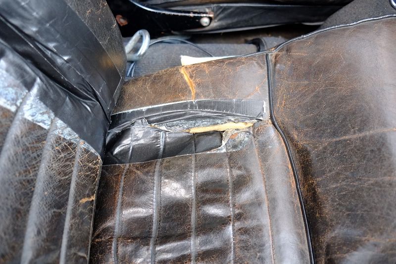

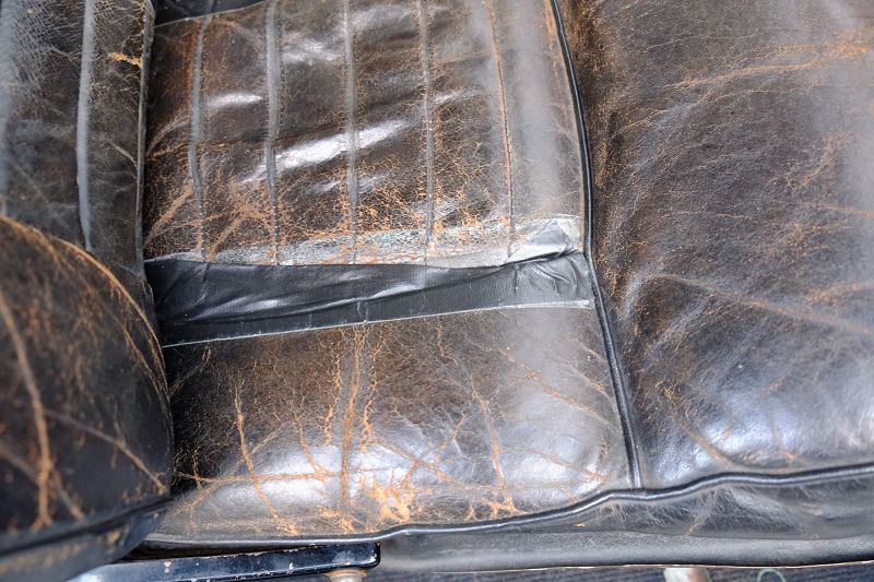

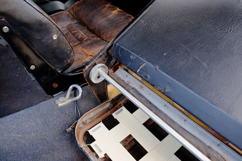

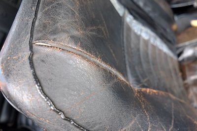

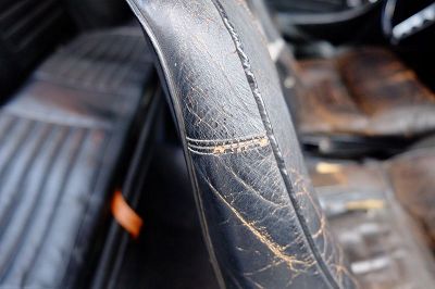

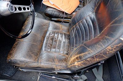

Following our exchange this morning concerning the renovation of the front seats of my old vehicle (50 years old!), here are some pictures.
The leather is very dry, loose in several places and has at least three major tears:
- one on the passenger seat (approx. 7cm)
- the same on the conductive seat
- the last one on the driver's seat back (not clearly visible in the pictures), about 20cm
I would add that the leather is colourless (black at first) and that the adhesive has ripped off the surface of the leather. Finally, the back of the seats seems to be made of leatherette.
Thank you for your advice and to indicate to me the approximate quantities of the products to be used.
Thomas

    Apparently you have the same leather as the old club chairs. Repair and recolouring are identical, for lamination and repair you need at least 150 gr of repair paste, we offer you 50 gr and the leather parts. To rehydrate the leather and for maintenance, a 250 ml can of Beef Foot Oil is required.
