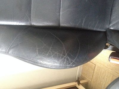

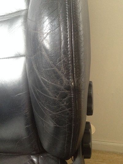

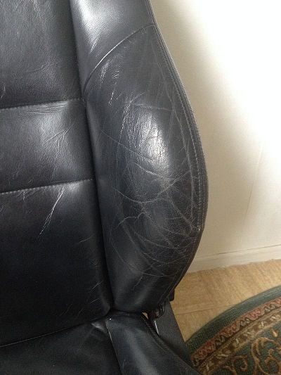

Hello I bought an interior Recaro black leather golf 4 and before installing it in my car I want to give it some color and close the wear marks if you can tell me which product (or kit) to use to restore it in good condition THANK YOU

    Your cracks are minimal, I advise you to sand lightly (sandpaper supplied with the kit) apply a first coat of pigment re-colouring agent and if the cracks still appear apply the black re-colouring paste (request to be specified in the comments) sand when the leather is well dry (about 2 hours) then apply a second coat of re-colourant. It seems on the picture that there is a little problem near a seam?
    Yes, there is a small lack due to a collision in my opinion we can plug it up again? so that it doesn't continue and that it makes a big hole for us
  3. Reply
    Does the hole pass through the leather to the foam?
  4. Reply
    No, it's not going through.
  5. Reply
    So no problem, you can plug the hole with the paste.
  6. Reply
    Okay, so which kit should I use for my seats?
