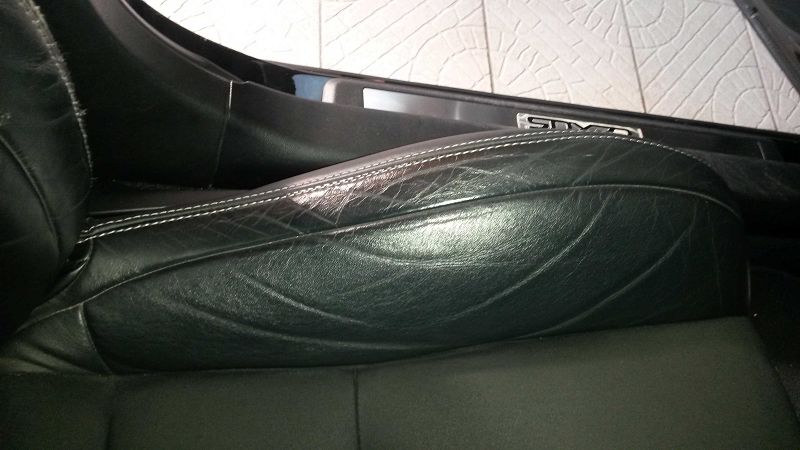

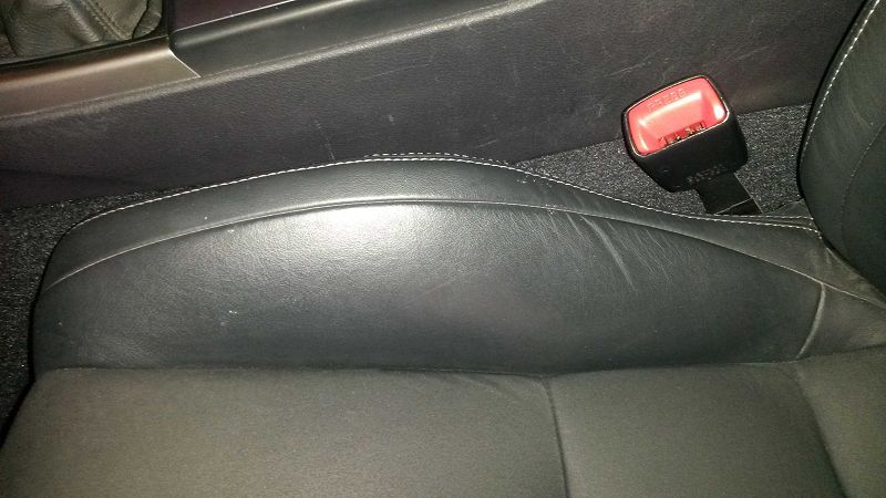

Hello I would like some advice to renovate the pleated side of my leather seat to have a smooth result identical to the other side and how to avoid it happening again... see photo... thank you

    To remove the wrinkles, the leather must be tightened either by wetting it thoroughly with a strong and fast drying process or by adding cotton wool between the leather and the foam. You can give it a smoother appearance by sanding it before re-colouring.
    Hello and thank you for your answer... I tried with water and then heat it up but it is without result, I have the impression that water has trouble penetrating the leather; as I ordered a renovation kit I will wait to receive this one to try sanding and recoloring.
