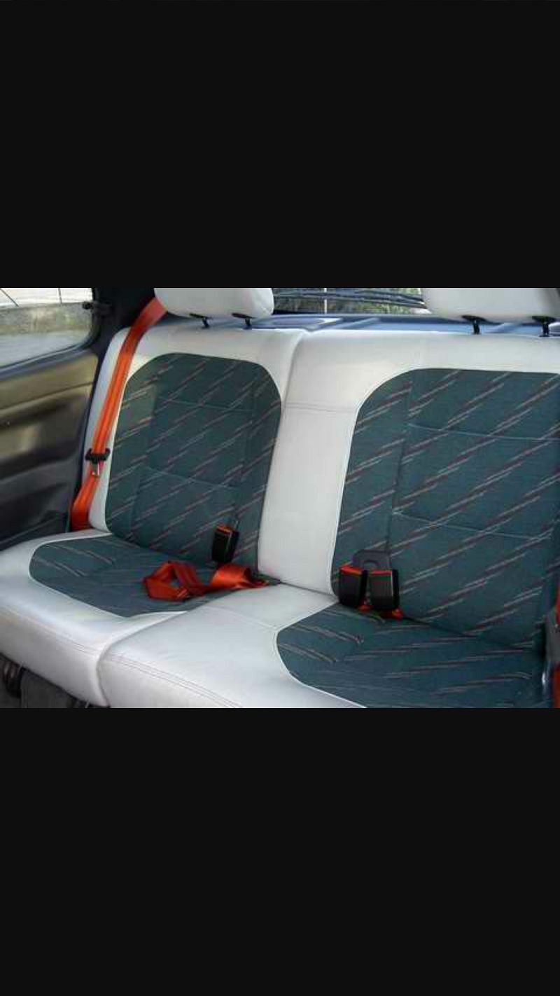

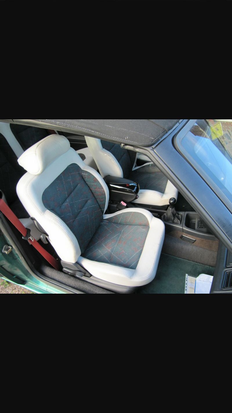

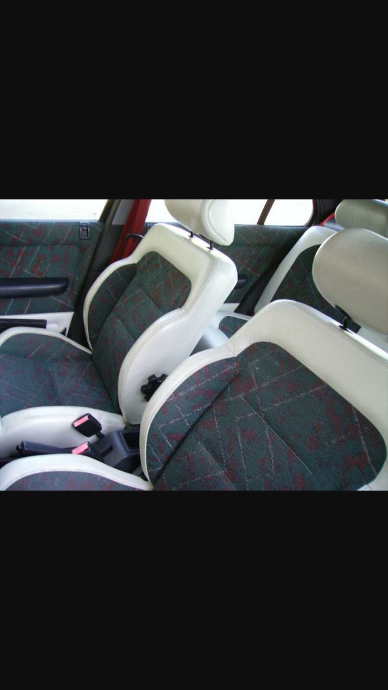

Hello I would need help to choose the finish of the varnish for the restoration of my leather interior of 306 roland garros phase 1, white color but matt satin or gloss finish? I will post pictures of the interior as soon as the subject is validated, if you could tell me if I should take the matt varnish or satin varnish instead would be perfect thank you

    Good evening,
    It is necessary to take the satin varnish. A matt varnish makes the colouring very matt and in your case the final result would not be beautiful.

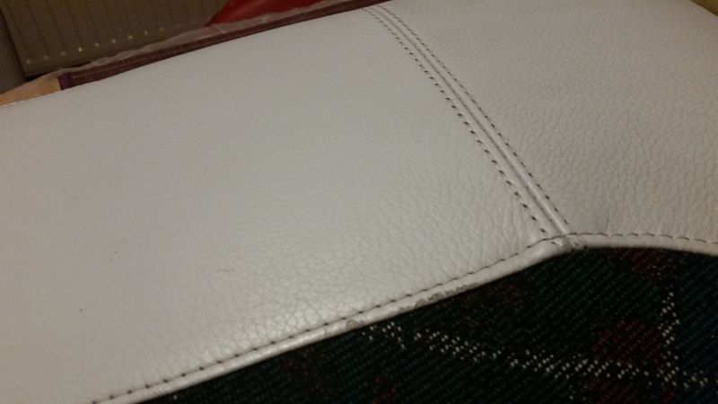

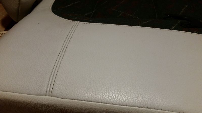

    Thank you for your quick answer, I thank you for the close pictures in this message, you are of course with the satin varnish to yellow the same aspect as the original one?
    I also wanted to ask you for confirmation regarding my leather which is not totally smooth (see attached photo) and that the repair and recoloration with your products are as possible? I might not have smoothing places because of the product?

    The pigment recolouring agent does not smooth a seed leather at all. After recolouring and varnishing your leather will regain its initial appearance after a few days, because the recolouring agent goes down a little bit into the leather if the stripping has been done properly.
