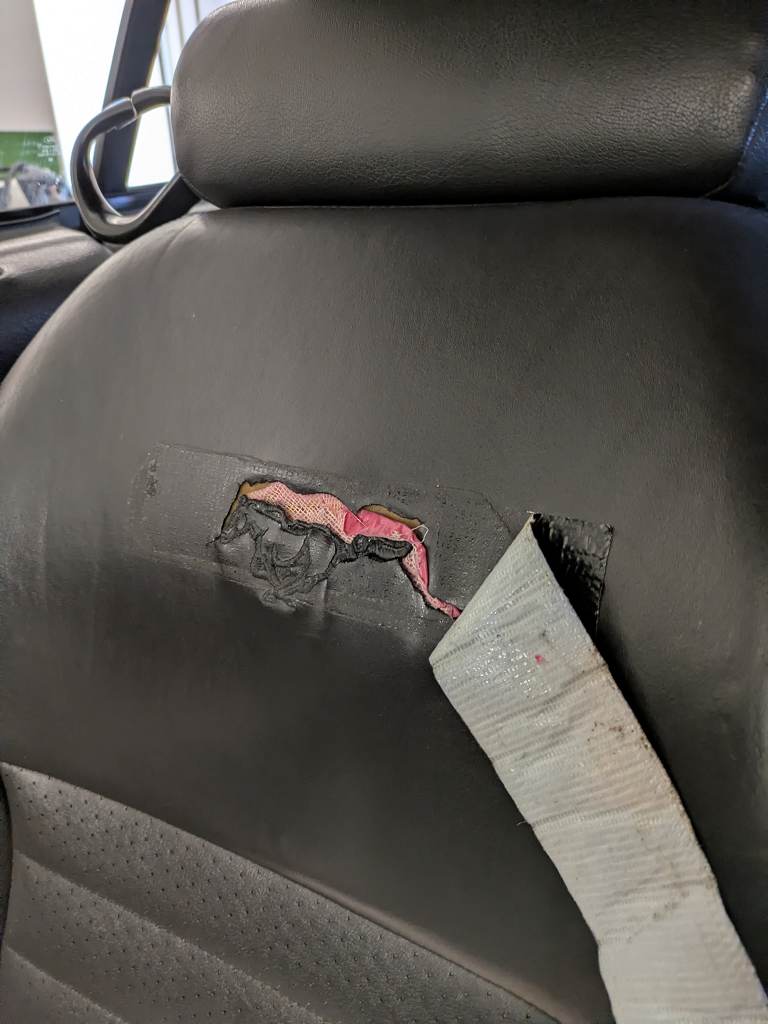

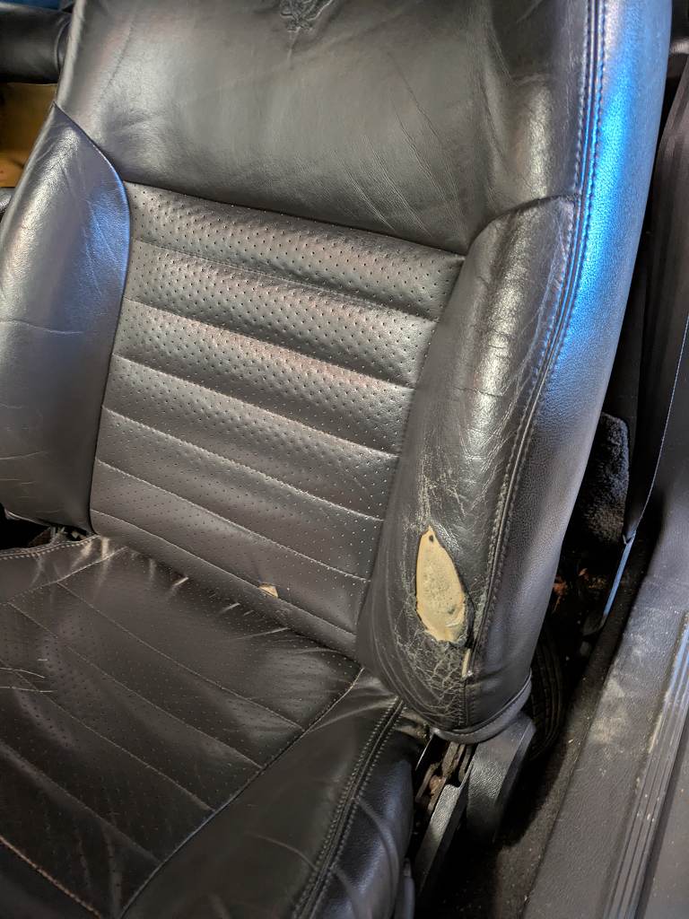

I have a Ford Mustang GT Convertible from 1999 with seats and a steering wheel that needs renovation.
My colour code is XW - Dark Charcoal.

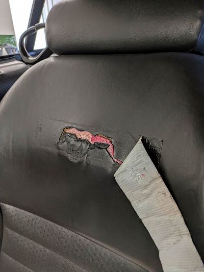

The drivers seat has a large hole near the seam and some smaller ones. The passenger seat is torn by the mustang logo. See attached pictures, the passenger seat tear was taped over by the previous owner.
Is this something that would be possible to repaired by an amateur?
What products and steps would I need to so to fix it?
At the same time I would also like to protect the rear seats, but they are in much better shape that the front seats.
I have a kit from you that I used to renovate the steering wheel of another car with good reslut, so I hope I can use the rest of that kit with new colour to renovate the streering wheel on this car too.

    Thank you for your message and for the photos you sent.
    A refurbishment is still a possibility, but we prefer to be transparent: given the extent of the visible damage, we cannot guarantee a result that is entirely satisfactory or long-lasting.
    The best solution would still be to contact an upholsterer to replace the most damaged leather parts, particularly around the edge of the driver’s seat, as the tears are very close to the seams.
    In fact, a repair would normally involve:
    sliding a non-woven fabric under the tear to create a stable base;
    gluing it in place;
    possibly reattaching a piece of leather to replace the missing material;
    then filling the seams with repair paste;
    and finally, recolouring and applying a varnish.
    The problem with the entry flap is that, given its immediate proximity to the seam, the non-woven fabric may not be able to be properly slipped under the torn area. This can therefore significantly limit the repair’s durability over time.
