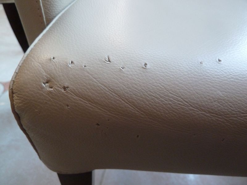

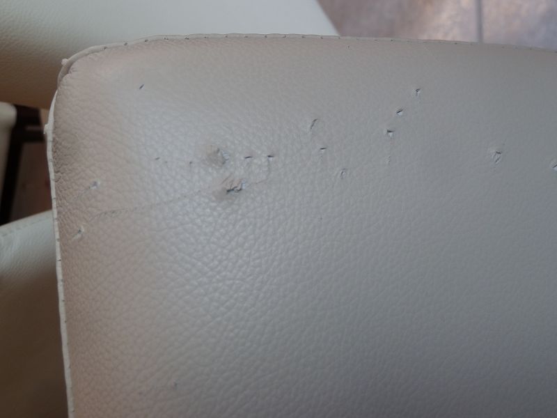

Hello could you recommend me how to repair these cat scratches on 2 of my beige leather armchairs (Panama Leather 5480 beige from protis) and which back products I buy? thank you in advance
  • Renovation of the armchair following cat scratches - 1
  • Renovation of the armchair following cat scratches - 2
    First you will have to use the leather healing agent to smooth as much as possible the raised parts and then fill the holes with the paste, recolour and varnish, this is the only valid solution.
