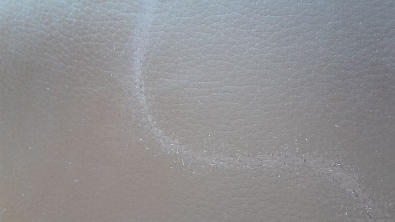

I tried to clean the leather seat of a chair stained with a blue pen and pen. Unfortunately the seat is now damaged and I would have liked to repair it. Is that possible? With which products? How to choose the colour of the leather? Thank you in advance.

    It is possible to repair the damage by applying our pigment re-colourant and varnish.
    Lightly sand the seat with fine sandpaper grain 240, degrease with acetone, recolour, varnish.
    for the choice of color, you can select a color on your screen, we will send you a paper color chart to confirm your choice.
    To make it easier for you, order an accessory kit, so you will have everything you need: tray, roller, brush, sandpaper.
