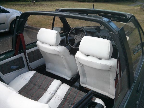

I recently ordered a complete kit to fully restore the upholstery of my Peugeot 205 convertible roland garros, which shows some cracks on the leather parts.
In order to reduce manufacturing costs, Peugeot has put leatherette on the backs of the seats and leather on the rest. I know this because several people have told me, but visually you don't see the difference.
When ordering, the white I ordered is very slightly whiter than the colour of the leather, it didn't want to but it doesn't bother me personally, the leatherette door panels are whiter than the seats. As its colors will be more harmonious.
I would like to know what are the effects/risks of the pigment recolouring agent on leather on leatherette? As it is a seat back, there is no special effort or movement as for a seat or the pads that are on both sides of the thighs.
In the case of the backs, a degreasing then recolorization and varnish is sufficient? or I apply the same procedure as for leather with nourishing oil?
Thank you in advance for your answer:)

    I would like to add that I cannot say what the leatherette pieces on the back are, whether it is the entire back or only the central part.
    As there is no traction and therefore no extension of the support, you can re-colour the leatherette with the pigment re-colouring agent. Do not degrease with the degreaser, but just with a little soapy water. Then re-colour your leatherette.
    Note that the varnish may be a little more difficult to spread because it is not intended for leatherette. Do not use any oil!
  3. Reply
    The leatherette parts are all those that "look" towards the rear window. The sides are made of leather.

    So if I understood correctly, the 5 parts that make up the back are made of leatherette, and the sides parallel to the doors are made of leather?
    I just started a back seat, the putty is put on and sanded, I apply some re-colouring with a brush around the seams as you explained it to me:)

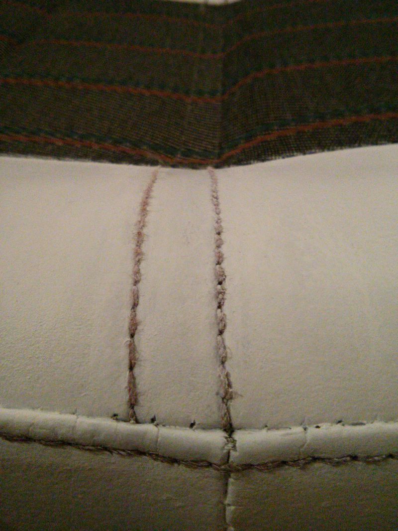

    This weekend I was able to start re-coloring the leathers, I have another question:
    The seams being red, and the leather white, I want to keep the red seams because they are part of the charm of the car.
    Over time a good part of it is discoloured and the red has become bland, I avoid as much as possible having recolouring on it but it is not obvious (I first make the outline of the seams with a fine brush and then I apply the recolouring by dabbing it with a foam, but it is not obvious to have a homogeneous colour afterwards).
    How can I recolour the seams? using a felt / marker / red paint?
    The seams should not fade if you come to sit on the seats with a slightly damp clothing after a rain.

    We have a hairspray to prevent the dyes from overflowing.

    I looked for your hairspray on the website but I didn't find it, would it be possible to have the link? As I will add it when I place my next order.

    The hairspray is a workshop product not for sale on the site. Send us an email with your name, we will send you a can of hairspray.
