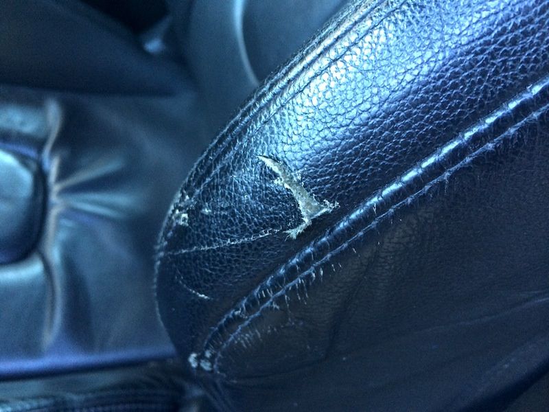

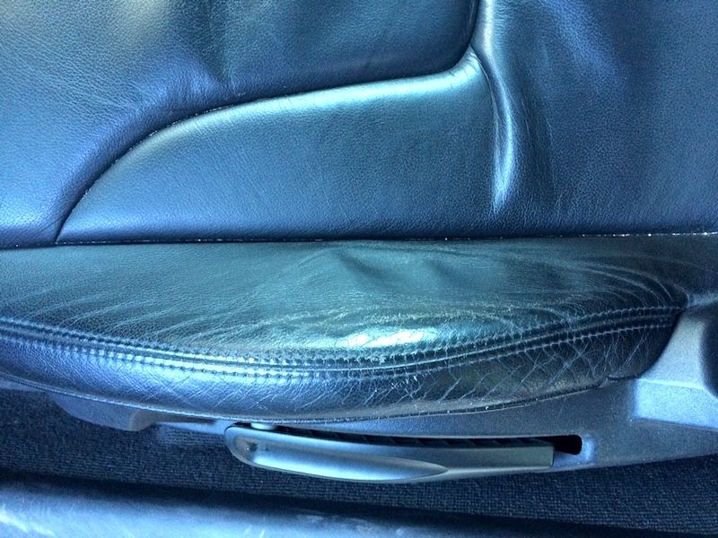

I just bought an Audi TT with a black leather interior, however driver's side, I have a seat that shows signs of wear on the lower left part, as well as a cut on the upper left part as well.
What do you recommend to me to revive my seat?

    The first thing to do is to repair the 2 tears by gluing a piece of leather between the foam and the leather (we will provide them to you). you will need the repair paste for this gluing and to fill the cracks before re-coloring the leather panels concerned. To glue the piece to the seam you will need a little Neoprene. If you follow our advice you can make an almost invisible repair.

    We did not find the images of a customer who had made a repair identical to the one you will have to make. We will detail the operations to be carried out and we commit you to call us. For the products you need, they are all in the renovation kit conductive seat. We will add paste and leather pieces.
