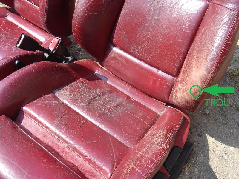

What products do you recommend for the renovation of this seat?
Deep cracks on the seat and backrest there is a small tear and the leather is very short and completely colourless, attached a picture.
thank you in advance for your answer.
  • car seat renovation
    The first thing to do is to feed the leather. We recommend Nourishing Oil, then sand the leather lightly (fine sandpaper that will not damage the leather). Apply the repair paste to block cracks, repair the hole by sliding a small piece of leather (we will provide it free of charge if you ask us in the comments when you order). Recolour and then varnish. You will find all these products in the car leather renovation kits
    Warning: wait 15 days for the oil to infiltrate.
