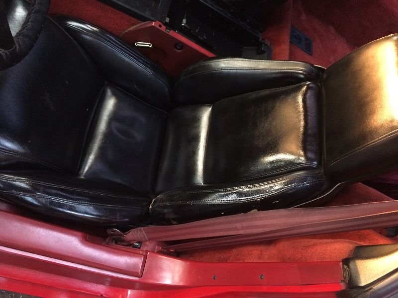

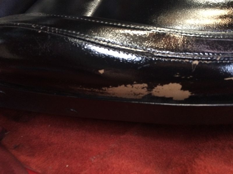

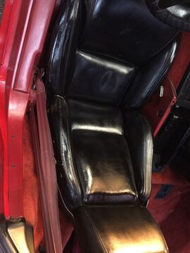

Hello, I just bought a 1985 Corvette C4... The seats are not really damaged but originally they were visibly beige (the original ones were too worn...) Now they are black but they look like they have been repainted with a black bomb... (Sunday handyman band...)I didn't find anything on the net if the seats are made of leather or PVC... I would have to remove the cover to see, which is impossible for the moment... Do you think it is possible to make a hook and re-dye these originally, i. e. "Rouge-Bordeaux"? A evening that the leather covers as originally proposed are offered at 1.638,00 Eur... Brrrrrrrrrrrrrrrrrrrrrrrrrrrrrrrrrrrrrrrrrrrrrrrrrrrrrrrrrrrrrrrrrrrrrrrrrrrrrr
    Please send us pictures to get more information. The problem of leather or leatherette will be easy to fix. In case of doubt, we will use a recolouring agent compatible with both materials.
    Thank you for the quick answer.
    Here are the pictures, I hope they will be suitable.
    • Reinstatement of Corvette C4 seats 1985 - 1
    • Reinstatement of Corvette C4 seats 1985 - 2
  3. Reply
    We think the first thing to do is to try to remove the black paint on a small surface (the least exposed) with acetone. If this recoloration starts easily it will be possible to consider a recoloration in burgundy red.

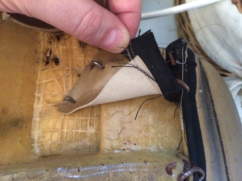

    Are you sure that the seats are made of leatherette, can you cut a slice of leather or leatherette under a seat with a cutter?
  12. Reply
    Yes 100% sure

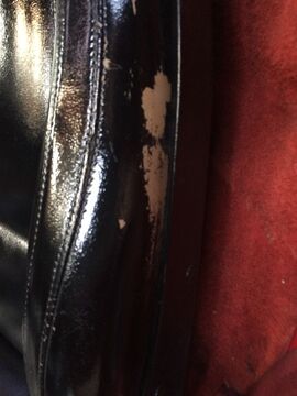

    Unfortunately black does not go to acetone and leatherette takes for its rank
  13. Reply
    If it's paint maybe that white spirit is more effective, we can't see on the picture if it's really leatherette, we need a close-up.
