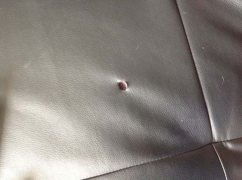

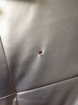

Hello, I have a problem, there is a hole made by a cigarette, in the middle of the seat on the seat of my Camaro 68, how to fix it?
Thank you. Thank you.
    Is the leather pierced?
    Yes, it's a good 5 millimeters in diameter, so the foam of the sofa is visible!
    • CIGARETTE HOLE
  3. Reply
    You have to slip a piece of leather between the foam and the flesh side of the leather, we will provide you with this piece that you will have to stick with the repair paste, it is the only solution to do a good job, you may need to enlarge the hole with two notches of 2 or 3 mm.
